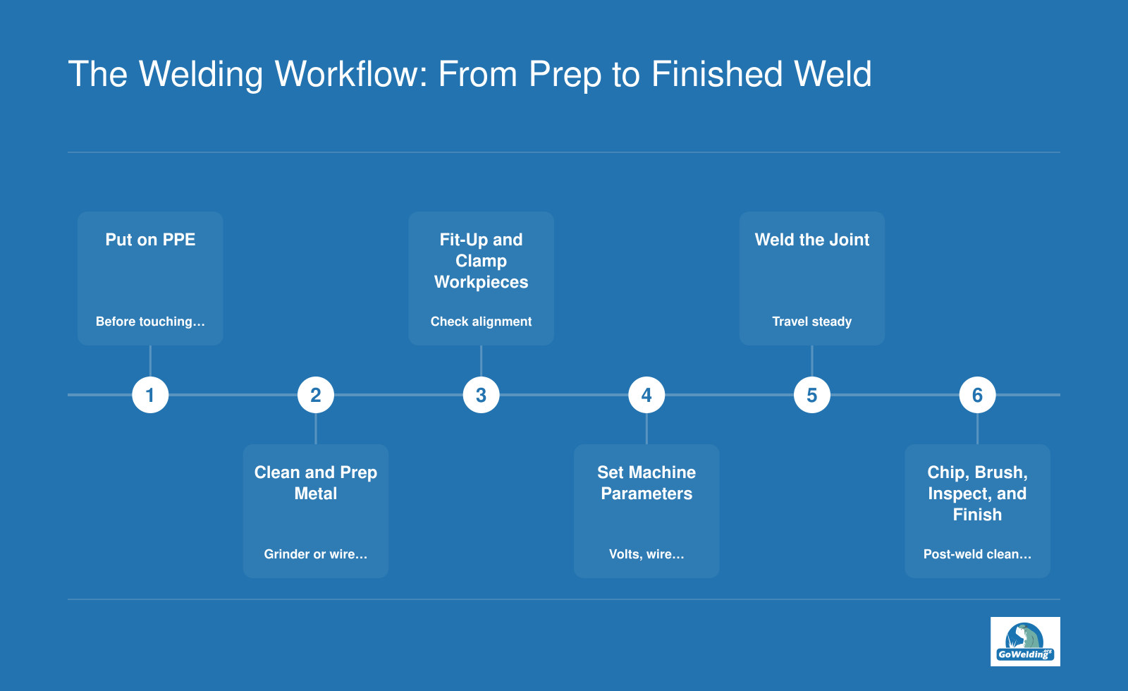

The Welding Workflow: From Prep to Finished Weld
A clean, safe weld follows the same order every time. Use this checklist as your mental sequence at the bench, in the booth, or on a job site.
Seven-step welding sequence from putting on personal protective equipment through cleaning, fit-up, welding, slag removal, and final inspection.

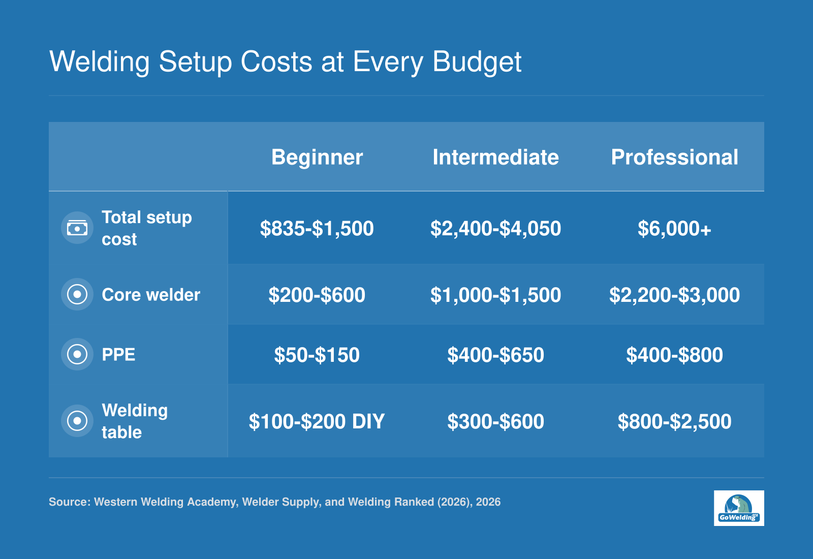

Welding Setup Costs at Every Budget
A usable beginner setup typically costs $835-$1,500, while a mid-range home shop often runs $2,400-$4,050 and a professional shop starts at $6,000. Above the machine and PPE, budget an extra $120-$295 for first-year beginner consumables, plus an angle grinder, clamps, and squares as you move up.
Beginner, intermediate, and professional welding setup cost ranges for total cost, core welder, PPE, and welding table.
