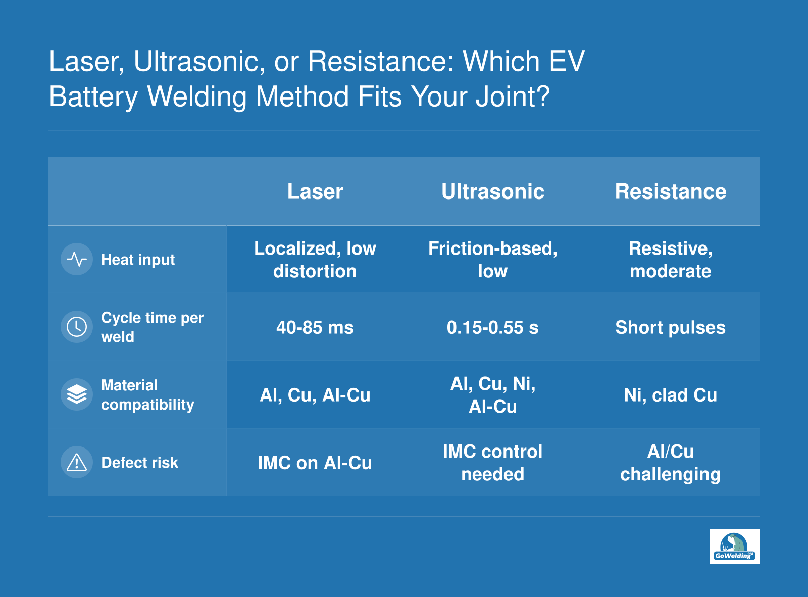

Laser, Ultrasonic, or Resistance: Which EV Battery Welding Method Fits Your Joint?
In tab joining, laser, ultrasonic, and resistance processes are not interchangeable: laser handles tab-to-busbar and high-speed scanning, ultrasonic excels at thin foils and tabs, and resistance suits nickel or clad-copper tabs in high-throughput cells. Busbar and enclosure work commonly uses laser for seams and terminals, while enclosures may add resistance or laser brackets and interconnects. Contact-resistance acceptance limits range from 0.3-1.0 mΩ by joint type, and a Cpk of 1.33 is a typical penetration-depth target.
EV battery welding comparison for tabs: laser 40-85 ms, ultrasonic 0.15-0.55 s, resistance across heat input, material compatibility, defect risk.
