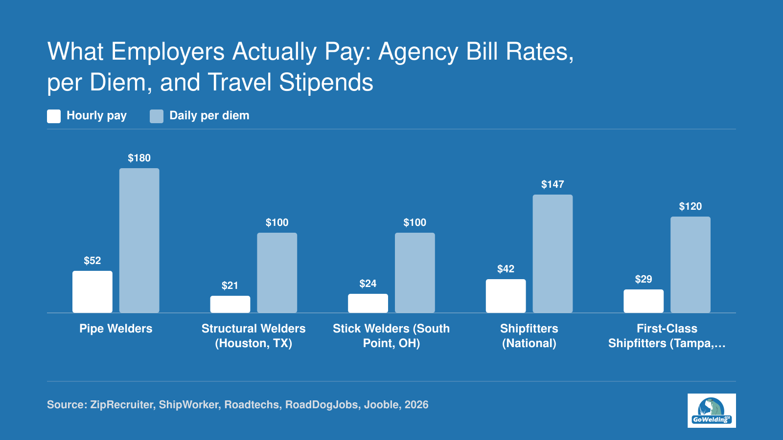

What Employers Actually Pay: Agency Bill Rates, per Diem, and Travel Stipends
Maritime staffing ads rarely publish the full bill rate, agency markup, or travel stipend. The chart below shows reported hourly pay and daily per diem from 2026 shipyard job postings; per diem generally applies only to eligible travelers and may help cover lodging. Helper postings list $13-$15 per hour with $135 daily per diem, but a single certified-helper rate is not established, so helpers are not charted; supervisor postings sometimes say lodging is paid without a dollar figure.
