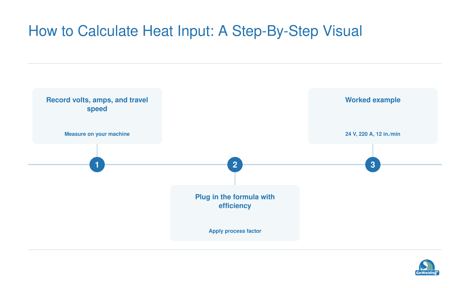

How to Calculate Heat Input: A Step-by-Step Visual
Heat input ties your machine settings to the energy delivered per inch of weld. It matters for procedure qualification and controlling distortion or cracking. Work from volts, amps, travel speed, and the process efficiency factor for the arc you are running.
Heat input calculation: 24 volts, 220 amps, 12 inches per minute, 0.80 efficiency equals 21.1 kilojoules per inch.

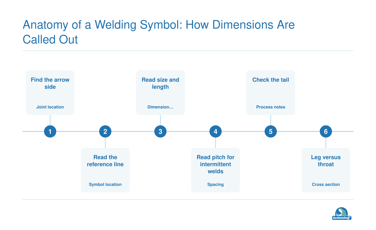

Anatomy of a Welding Symbol: How Dimensions Are Called Out
Welding symbols pack a lot of information into a few lines. Once you can identify the arrow, reference line, and tail, the dimensions tell you exactly what size and length of weld to make.
Fillet weld symbol with arrow, reference line, tail, and dimension callouts for size, length, pitch, leg, and throat.
