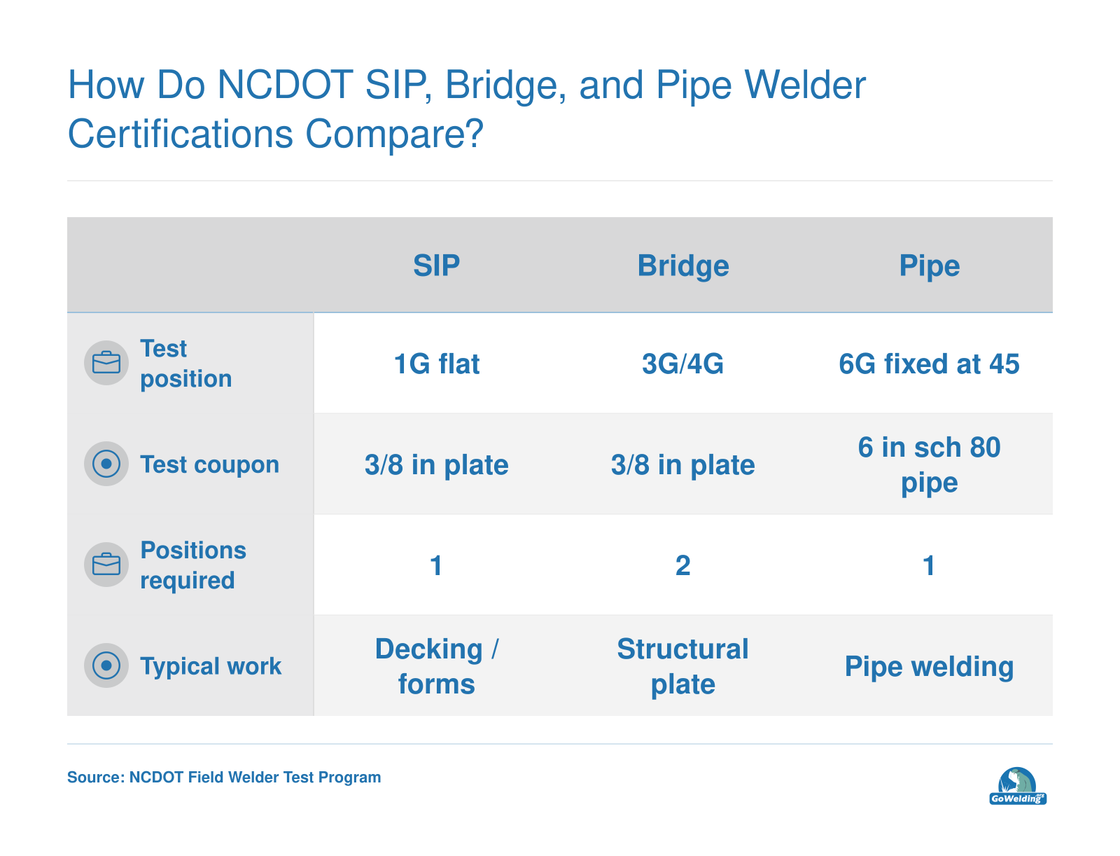

How Do NCDOT SIP, Bridge, and Pipe Welder Certifications Compare?
NCDOT field welder certifications are not interchangeable. The flat-plate SIP test qualifies you for decking and stay-in-place form work, while Bridge adds vertical and overhead structural plate positions, and Pipe uses a fixed 6G pipe test.
Comparison of three welder certifications across test position, coupon, required tests, and typical work.
