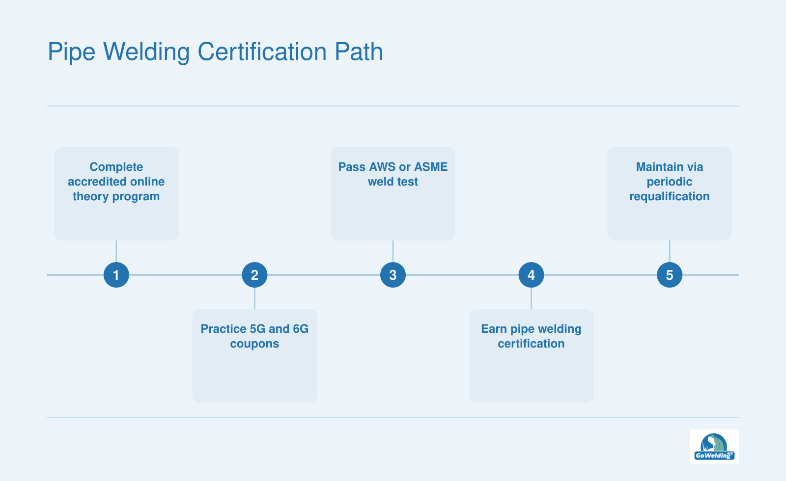

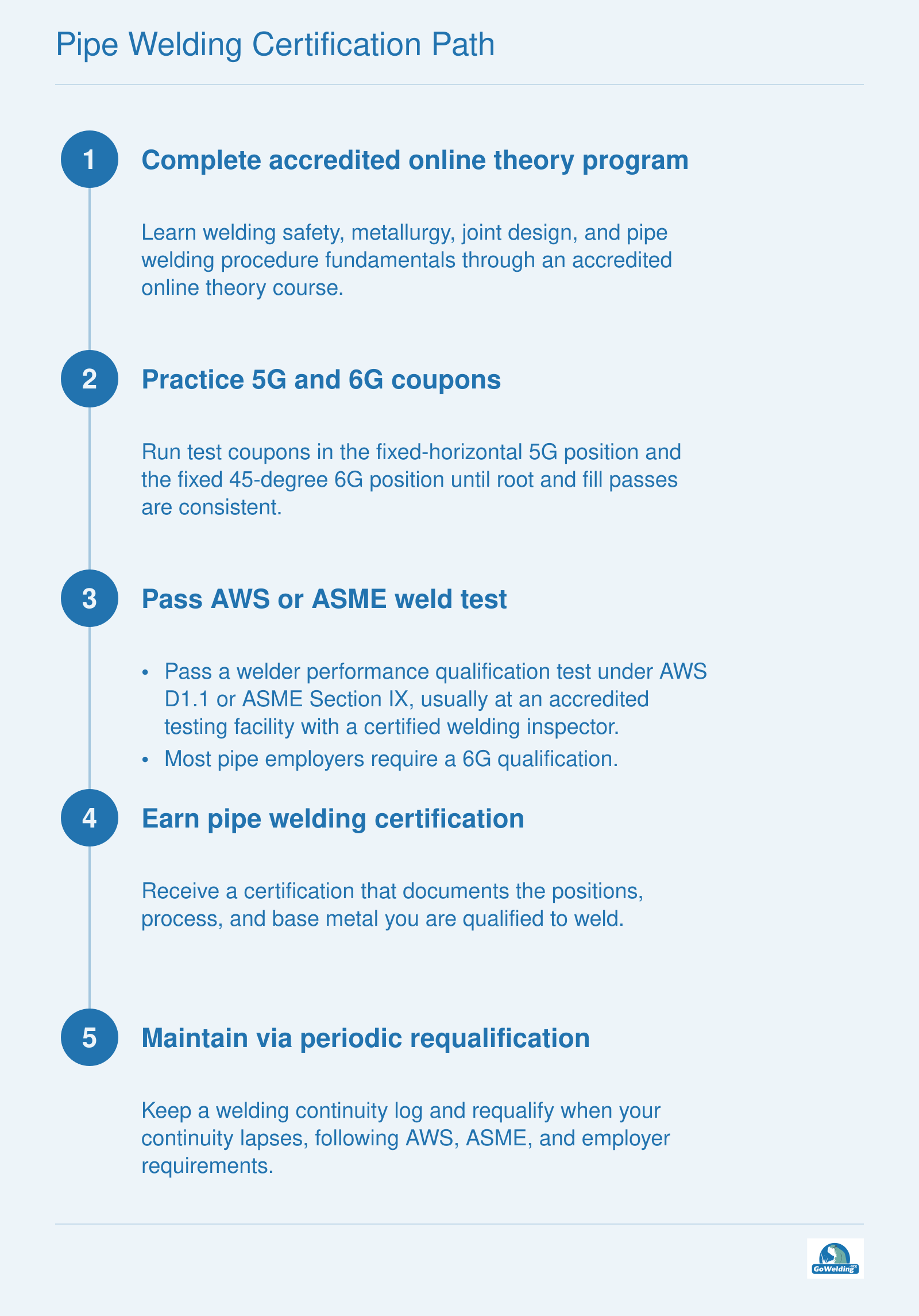

Pipe Welding Certification Path
Pipe welding certification follows a fixed sequence. Employers rarely accept classroom hours alone; they want a qualified weld test and an active qualification you can document. This path shows the typical credentialing ladder for pipe welding.
